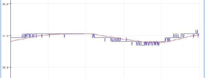

Arduino+LM35+kalman+i2C_lcd, 加入卡爾曼濾波顯示溫度比較度穩定, 可顯示小數後三位。 /* This sample code demonstrates how to use the SimpleKalmanFilter object. Use a potentiometer in Analog input A0 as ...
