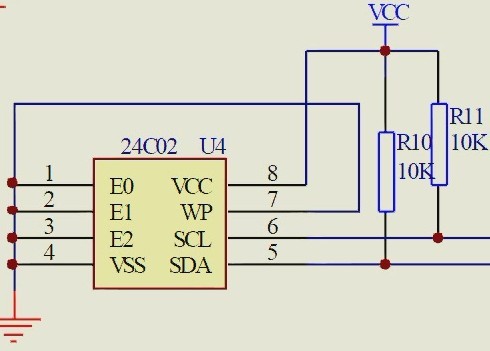

AT24C02A, 2K SERIAL EEPROM: Internally organized with 32 pages of 8 bytes each, the 2K requires an 8-bit data word address for random word addressing. 24c02有32個頁,每頁8字節,本帖中不討論頁寫的方 ...
