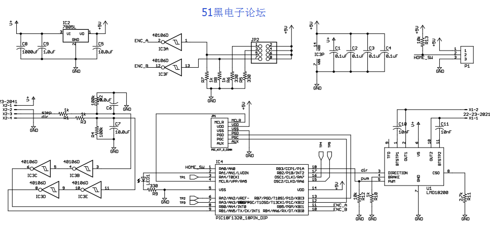

基于PIC18系列單片機的直流有刷伺控制系統:(來處于國外貼)

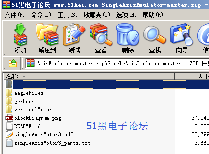

1:原理圖(PDF)
2:原理圖及PCB圖(EAGLE)
3:帶pid + 編碼器的控制程序。main.c
電路原理圖如下:
單片機源程序如下:

  242.         TRISBbits.TRISB2 = 1;
  243.         /* Use PR2 to set the PWM period */
  244.         PR2 = 0xFF;
  245.         // Equation 15-1 PWM Period = [(PR2 + 1)] * 4 * TOSC * TMR2 Prescaler
  246.         // or about 1 / 490Hz
  247.         /* Set PWM Mode with P1A as a single modulated output */
  248.         CCP1CONbits.CCP1M0 = 0;
  249.         CCP1CONbits.CCP1M1 = 0;
  250.         CCP1CONbits.CCP1M2 = 1;
  251.         CCP1CONbits.CCP1M3 = 1;
  252.         CCP1CONbits.P1M0 = 0;
  253.         CCP1CONbits.P1M1 = 0;
  254.         /* LSB of the PWM duty cycle */
  255.         CCP1CONbits.DC1B1 = 0;
  256.         CCP1CONbits.DC1B0 = 0;
  257.         /* MSB of the PWM duty cycle */
  258.         CCPR1L = 0x00;
  259.
  260.         /* Configure TMR2 */
  261.         PIR1bits.TMR2IF = 0;        // Clear interupt flag for TMR2 equal to PR2
  262.         T2CONbits.T2CKPS1 = 1;  // Set prescaler to 16 to decrease PWM frequency
  263.         T2CONbits.T2CKPS0 = 1;
  264.         T2CONbits.TMR2ON = 1; // Turn on Timer2
  265.
  266.         /* Wait for the TMR2IF flag go high before procedding */
  267.         while (!(PIR1bits.TMR2IF))
  268.         {
  269.                 int temp = 0;
  270.         }
  271.         /* Set the PWM pins P1A and P1B as outputs. */
  272.         TRISBbits.TRISB3 = 0;
  273.         TRISBbits.TRISB2 = 0;
  274.         ECCPASbits.ECCPASE = 0;
  275.         /*****************************************************/
  276.         /***************** SET OSC SPEED *********************/
  277.     //OSCCONbits.IRCF0 = 1;
  278.         //OSCCONbits.IRCF1 = 1;
  279.         //OSCCONbits.IRCF2 = 1;
  280.     OSCCONbits.IRCF0 = 1;
  281.         OSCCONbits.IRCF1 = 1;
  282.         OSCCONbits.IRCF2 = 1;
  283.         /*****************************************************/
  284.
  285.         // This line is part of the initial check sequence and is not
  286.         // needed for normal operation:
  287.         desiredCounter = 0;
  288.         trigger = 0;
  289.         stepPulses = 0;
  290.         currentCounter = 0;
  291.
  292.         set_motor_output( 0, 0 );
  293.         /****************** ENABLE INTERRUPTS *****************/
  294.         INTCONbits.GIEH = 1;                 // Enable global interrupts
  295.         INTCONbits.GIEL = 1;                 // Enable peripheral innterupts
  296.         /******************************************************/
  297.
  298.         while (1)
  299.         {
  300.                 INTCONbits.GIEH = 0;
  301.                         tempTrigger = trigger;
  302.                 INTCONbits.GIEH = 1;
  303.
  304.                 if ( tempTrigger )
  305.                 {
  306.                         INTCONbits.GIEH = 0;
  307.                                 trigger = 0;
  308.                                 tempCurrentCounter = currentCounter;
  309.                                 tempStepPulses = stepPulses;
  310.                                 stepPulses = 0;
  311.                                 // Check if step pin has been held HIGH.  If it has been held HIGH
  312.                                 // long enough to indicate a HOME command, set home flag, otherwise
  313.                                 // just increment stepHighCounter.  stepHighCounter gets reset in
  314.                                 // in interrupt routine that reads step and direction lines.
  315.                                 if (stepHighCounter) {
  316.                                         if (stepHighCounter > stepHomeThreshold) {
  317.                                                 homeFlag = 1;
  318.                                                 stepHighCounter = 0;
  319.                                                 homeDir = PORTBbits.RB1; //set home direction to direction input pin
  320.                                         }
  321.                                         else {
  322.                                                 if (PORTBbits.RB0) {
  323.                                                         stepHighCounter++;
  324.                                                 }
  325.                                         }
  326.                                 }
  327.                                 //stepTimerFoo++;
  328.                                 //tempStepTimerFoo = stepTimerFoo;
  329.                         INTCONbits.GIEH = 1;
  330.
  331.
  332.                         // if tempStepTimerFoo > something
  333.                         //    then set homeFlag, set homeDir
  334.                         // if homeflag
  335.                                 // if homeswitch
  336.                                 //                turn off homing
  337.                                 //        else
  338.                                 //                set motor go to home in homeDir direction
  339.                                 //        end
  340.                         //else
  341.                         //        do normal motor control
  342.                         //end
  343.
  344.
  345. /*
  346.                         INTCONbits.GIEH = 0;
  347.                                 trigger = 0;
  348.                         INTCONbits.GIEH = 1;
  349.
  350.                         //if (PORTAbits.RA1)
  351.                         //        PORTAbits.RA1 = 0;
  352.                         //else
  353.                         //        PORTAbits.RA1 = 1;
  354.                         INTCONbits.GIEH = 0;
  355.                                 tempCurrentCounter = currentCounter;
  356.                                 tempStepPulses = stepPulses;
  357.                                 stepPulses = 0;
  358.                         INTCONbits.GIEH = 1; */
  359.                 //        velocity = (tempCurrentCounter - prevCounter)*counterToSpeedScalar;
  360.                 //        prevCounter = tempCurrentCounter;
  361.
  362.                         // Uncomment this for normal operation
  363.                         desiredCounter = desiredCounter + (tempStepPulses*numCountsPerStep);
  364.
  365.                         if (homeFlag) // If we are in homing mode
  366.                         {
  367.                                 if (PORTAbits.RA0) // if homeswitch is ON
  368.                                 {
  369.                                         // We're home!
  370.                                         set_motor_output(0,0);
  371.                                         homeFlag = 0;
  372.                                         desiredCounter = 0;
  373.
  374.                                         // turn off interrupts to clear sensitive variables
  375.                                         INTCONbits.GIEH = 0;
  376.                                                 currentCounter = 0;
  377.                                         INTCONbits.GIEH = 1;
  378.                                 }
  379.                                 else // if homeswitch is OFF - we are still going home
  380.                                 {
  381.                                         if (homeDir) // going up
  382.                                         {
  383.                                                 set_motor_output(abs(upTorqueLimit),1);
  384.                                         }
  385.                                         else // going down
  386.                                         {
  387.                                                 set_motor_output(abs(downTorqueLimit), 0);
  388.                                         }
  389.                                 }
  390.                         }
  391.                         else
  392.                         {
  393.                                 error = desiredCounter - tempCurrentCounter;
  394.                                 output =  Kp * error;
  395.                                 ////////////// Set motor output //////////////////////////////
  396.                                 //
  397.                                 // The variable "output" controls voltage to motor. Examples:
  398.                                 //
  399.                                 // this makes the motor go up:
  400.                                 // set_motor_output(30,1);
  401.                     //
  402.                                 // this makes the motor go down:
  403.                                 // set_motor_output(30,0);
  404.                                 //
  405.                                 if (output <= 0)
  406.                                 {
  407.                                         if (output < downTorqueLimit)
  408.                                         {
  409.                                                 output = downTorqueLimit;
  410.                                         }
  411.                                         set_motor_output(abs(output),0);
  412.                                 }
  413.                                 else
  414.                                 {
  415.                                         if (output > upTorqueLimit)
  416.                                         {
  417.                                                 output = upTorqueLimit;
  418.                                         }
  419.                                         set_motor_output(abs(output),1);
  420.                                 }
  421.                         }
  422.                 }
  423.         }
  424. }
Partlist
Exported from singleAxisMotor3.sch at 2/16/2014 12:03:57 PM
EAGLE Version 6.5.0 Copyright (c) 1988-2013 CadSoft
Assembly variant:
Part     Value                Device               Package        Library             Sheet
C1       0.1uF                C-USC1206            C1206          rcl                 1
C2       0.1uF                C-USC1206            C1206          rcl                 1
C3       0.1uF                C-USC1206            C1206          rcl                 1
C4       0.1uF                C-USC1206            C1206          rcl                 1
C5       10.0uF               C-US025-024X044      C025-024X044   rcl                 1
C6       10.0uF               C-USC1206            C1206          rcl                 1
C7       10.0uF               C-USC1206            C1206          rcl                 1
C8       1000uF               C-US025-024X044      C025-024X044   rcl                 1
C9       1.0uF                C-USC1206            C1206          rcl                 1
C10      10nF                 C-USC1206            C1206          rcl                 1
C11      10nF                 C-USC1206            C1206          rcl                 1
IC2      7805L                7805L                TO92           linear              1
IC3      40106D               40106D               SO14           40xx                1
IC4      PIC18F1320_18PIN_DIP PIC18F1320_18PIN_DIP SO-18W         modular_robot_parts 1
JP1      PIC_KIT_2_CONN       PIC_KIT_2_CONN       PIC_KIT_2_CONN modular_robot_parts 1
JP2                           PINHD-2X4            2X04           pinhead             1
LED1                          LEDCHIPLED_1206      CHIPLED_1206   led                 1
P1       3PIN                 3PIN                 3PIN           custom              1
R1       1k                   R-US_0207/2V         0207/2V        rcl                 1
R2       100k                 R-US_0207/2V         0207/2V        rcl                 1
R3       1k                   R-US_0207/2V         0207/2V        rcl                 1
R4       100k                 R-US_0207/2V         0207/2V        rcl                 1
R5       330                  R-US_0207/2V         0207/2V        rcl                 1
R6       330                  R-US_0207/2V         0207/2V        rcl                 1
R7       1k                   R-US_0207/2V         0207/2V        rcl                 1
R8       1k                   R-US_0207/2V         0207/2V        rcl                 1
R9       330                  R-US_0207/2V         0207/2V        rcl                 1
R10      1k                   R-US_M1206           M1206          rcl                 1
R11      2.7k                 R-US_M1206           M1206          rcl                 1
R12      10k                  R-US_M1206           M1206          rcl                 1
R13      10k                  R-US_M1206           M1206          rcl                 1
TP1      1PAD                 1PAD                 1PAD           custom              1
TP2      1PAD                 1PAD                 1PAD           custom              1
TP3      1PAD                 1PAD                 1PAD           custom              1
TP4      1PAD                 1PAD                 1PAD           custom              1
TP5      1PAD                 1PAD                 1PAD           custom              1
U1       LMD18200             LMD18200             TO-220-WIDE    custom              1
X1       22-23-2021           22-23-2021           22-23-2021     con-molex           1
X2       22-23-2041           22-23-2041           22-23-2041     con-molex           1
所有資料51hei提供下載:
SingleAxisEmulator-master.zip (282.84 KB, 下載次數: 42)
