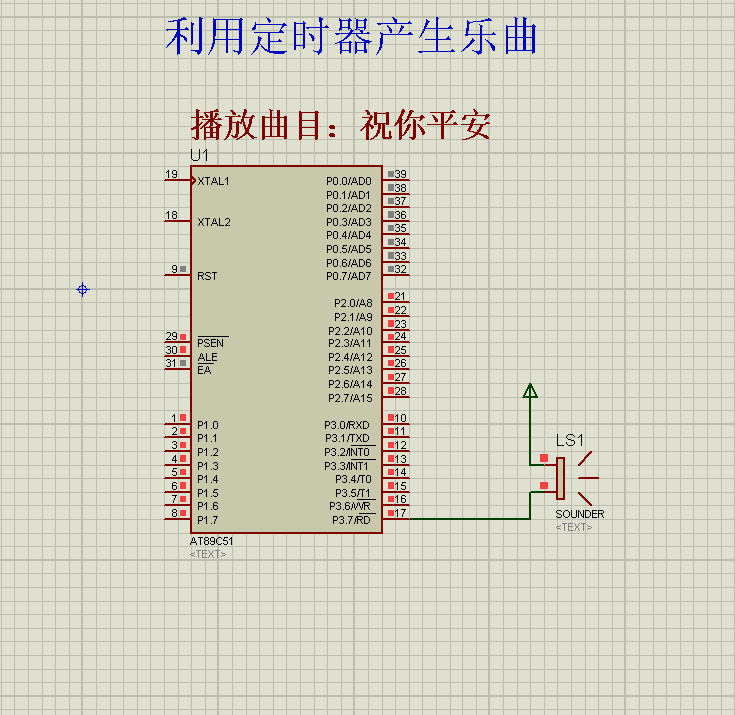

利用定時器產生樂曲仿真原理圖如下(proteus仿真工程文件可到本帖附件中下載)

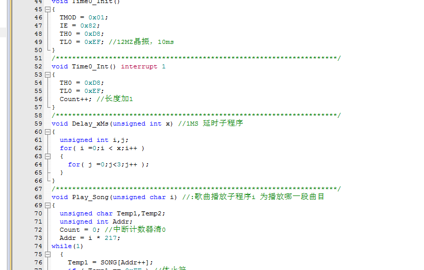

單片機源碼:
  1. #include<reg52.h>                 //庫文件
  2. #define uchar unsigned char//宏定義無符號字符型
  3. #define uint unsigned int  //宏定義無符號整型
  4. /********************************************************************
  5.                             初始定義
  6. *********************************************************************/
  7. uchar Count;
  8. sbit _Speak =P3^7 ; //訊響器控制腳
  9. /********************************************************************
  10.                             歌曲字根碼
  11. *********************************************************************/
  12. unsigned char code SONG[] ={ //祝你平安
  13. 0x26,0x20,0x20,0x20,0x20,0x20,0x26,0x10,0x20,0x10,0x20,0x80,0x26,0x20,0x30,0x20,
  14. 0x30,0x20,0x39,0x10,0x30,0x10,0x30,0x80,0x26,0x20,0x20,0x20,0x20,0x20,0x1c,0x20,
  15. 0x20,0x80,0x2b,0x20,0x26,0x20,0x20,0x20,0x2b,0x10,0x26,0x10,0x2b,0x80,0x26,0x20,
  16. 0x30,0x20,0x30,0x20,0x39,0x10,0x26,0x10,0x26,0x60,0x40,0x10,0x39,0x10,0x26,0x20,
  17. 0x30,0x20,0x30,0x20,0x39,0x10,0x26,0x10,0x26,0x80,0x26,0x20,0x2b,0x10,0x2b,0x10,
  18. 0x2b,0x20,0x30,0x10,0x39,0x10,0x26,0x10,0x2b,0x10,0x2b,0x20,0x2b,0x40,0x40,0x20,
  19. 0x20,0x10,0x20,0x10,0x2b,0x10,0x26,0x30,0x30,0x80,0x18,0x20,0x18,0x20,0x26,0x20,
  20. 0x20,0x20,0x20,0x40,0x26,0x20,0x2b,0x20,0x30,0x20,0x30,0x20,0x1c,0x20,0x20,0x20,
  21. 0x20,0x80,0x1c,0x20,0x1c,0x20,0x1c,0x20,0x30,0x20,0x30,0x60,0x39,0x10,0x30,0x10,
  22. 0x20,0x20,0x2b,0x10,0x26,0x10,0x2b,0x10,0x26,0x10,0x26,0x10,0x2b,0x10,0x2b,0x80,
  23. 0x18,0x20,0x18,0x20,0x26,0x20,0x20,0x20,0x20,0x60,0x26,0x10,0x2b,0x20,0x30,0x20,
  24. 0x30,0x20,0x1c,0x20,0x20,0x20,0x20,0x80,0x26,0x20,0x30,0x10,0x30,0x10,0x30,0x20,
  25. 0x39,0x20,0x26,0x10,0x2b,0x10,0x2b,0x20,0x2b,0x40,0x40,0x10,0x40,0x10,0x20,0x10,
  26. 0x20,0x10,0x2b,0x10,0x26,0x30,0x30,0x80,0x00,
  27. //路邊的野華不要采
  28. 0x30,0x1C,0x10,0x20,0x40,0x1C,0x10,0x18,0x10,0x20,0x10,0x1C,0x10,0x18,0x40,0x1C,
  29. 0x20,0x20,0x20,0x1C,0x20,0x18,0x20,0x20,0x80,0xFF,0x20,0x30,0x1C,0x10,0x18,0x20,
  30. 0x15,0x20,0x1C,0x20,0x20,0x20,0x26,0x40,0x20,0x20,0x2B,0x20,0x26,0x20,0x20,0x20,
  31. 0x30,0x80,0xFF,0x20,0x20,0x1C,0x10,0x18,0x10,0x20,0x20,0x26,0x20,0x2B,0x20,0x30,
  32. 0x20,0x2B,0x40,0x20,0x20,0x1C,0x10,0x18,0x10,0x20,0x20,0x26,0x20,0x2B,0x20,0x30,
  33. 0x20,0x2B,0x40,0x20,0x30,0x1C,0x10,0x18,0x20,0x15,0x20,0x1C,0x20,0x20,0x20,0x26,
  34. 0x40,0x20,0x20,0x2B,0x20,0x26,0x20,0x20,0x20,0x30,0x80,0x20,0x30,0x1C,0x10,0x20,
  35. 0x10,0x1C,0x10,0x20,0x20,0x26,0x20,0x2B,0x20,0x30,0x20,0x2B,0x40,0x20,0x15,0x1F,
  36. 0x05,0x20,0x10,0x1C,0x10,0x20,0x20,0x26,0x20,0x2B,0x20,0x30,0x20,0x2B,0x40,0x20,
  37. 0x30,0x1C,0x10,0x18,0x20,0x15,0x20,0x1C,0x20,0x20,0x20,0x26,0x40,0x20,0x20,0x2B,
  38. 0x20,0x26,0x20,0x20,0x20,0x30,0x30,0x20,0x30,0x1C,0x10,0x18,0x40,0x1C,0x20,0x20,
  39. 0x20,0x26,0x40,0x13,0x60,0x18,0x20,0x15,0x40,0x13,0x40,0x18,0x80,0x00,};
  40. /********************************************************************
  41.                             定時中斷服務函數
  42. *********************************************************************/
  43. void Time0_Init()
  44. {
  45.         TMOD = 0x01;
  46.         IE = 0x82;
  47.         TH0 = 0xD8;
  48.         TL0 = 0xEF; //12MZ晶振,10ms
  49. }
  50. /*********************************************************************/
  51. void Time0_Int() interrupt 1
  52. {
  53.         TH0 = 0xD8;
  54.         TL0 = 0xEF;
  55.         Count++; //長度加1
  56. }
  57. /*********************************************************************/
  58. void Delay_xMs(unsigned int x) //1MS 延時子程序
  59. {
  60.         unsigned int i,j;
  61.         for( i =0;i < x;i++ )
  62.         {
  63.                 for( j =0;j<3;j++ );
  64.         }
  65. }
  66. /*********************************************************************/
  67. void Play_Song(unsigned char i) //:歌曲播放子程序i 為播放哪一段曲目
  68. {
  69.         unsigned char Temp1,Temp2;
  70.         unsigned int Addr;
  71.         Count = 0; //中斷計數器清0
  72.         Addr = i * 217;
  73. while(1)
  74.         {
  75.                 Temp1 = SONG[Addr++];
  76.                 if ( Temp1 == 0xFF ) //休止符
  77.                         {
  78.                                 TR0 = 0; Delay_xMs(100);
  79.                         }
  80.         else if ( Temp1 == 0x00 ) //歌曲結束符
  81.                 {
  82.                         return;
  83.                 }
  84. else
  85. {
  86.         Temp2 = SONG[Addr++];
  87.         TR0 = 1;
  88.         while(1)
  89.         {
  90.         _Speak = ~_Speak;
  91.         Delay_xMs(Temp1);
  92.         if ( Temp2 == Count )
  93.                 {
  94.                         Count = 0;
  95.                         break;
  96.                 }
  97.         }
  98. }
  99. }
  100. }
  101. /********************************************************************
  102.                             主函數
  103. *********************************************************************/
  104. void main() //主程序
  105. {
  106.         Time0_Init(); //定時器0 中斷初始化
  107.         while(1)
  108.         {
  109.                 Play_Song(0);
  110.         } //播放
  111. }
  112. /********************************************************************
  113.                               結束
  114. *********************************************************************/
