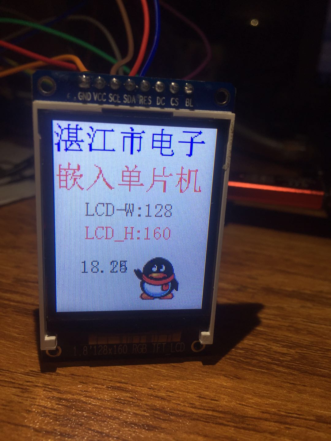

在網上看到stm32驅動1.8寸tft-lcd(st7735)的程序挺少的,所以本人弄了一個程序,程序絕對可行(本人弄的)
芯片:stm32f10x系列
單片機源程序如下:

  7. int main(void)
  8. {
  9.         float t=0;
  10.         delay_init();
  11.         LED_Init();//LED初始化
  12.         LCD_Init();//LCD初始化
  13.         LCD_Fill(0,0,LCD_W,LCD_H,WHITE);
  14.         LED=0;
  15.         while(1)
  16.         {
  17.                 LCD_ShowChinese(0,0,"湛江市電子",BLUE,WHITE,24,0);
  18.                 LCD_ShowChinese(0,30,"嵌入單片機",RED,WHITE,24,0);
  19.
  20.                 LCD_ShowString(24,60,"LCD-W:", BROWN ,WHITE,16,0);
  21.                 LCD_ShowIntNum(72,60,LCD_W,3, BROWN ,WHITE,16);
  22.                 LCD_ShowString(24,80,"LCD_H:",RED,WHITE,16,0);
  23.                 LCD_ShowIntNum(72,80,LCD_H,3,RED,WHITE,16);
  24.
  25.                 LCD_ShowFloatNum1(20,110,t,4,BLACK,WHITE,16);
  26.                 t+=0.11;
  27.                 LCD_ShowPicture(65,110,40,40,gImage_1);
  28.         }
  29. }
