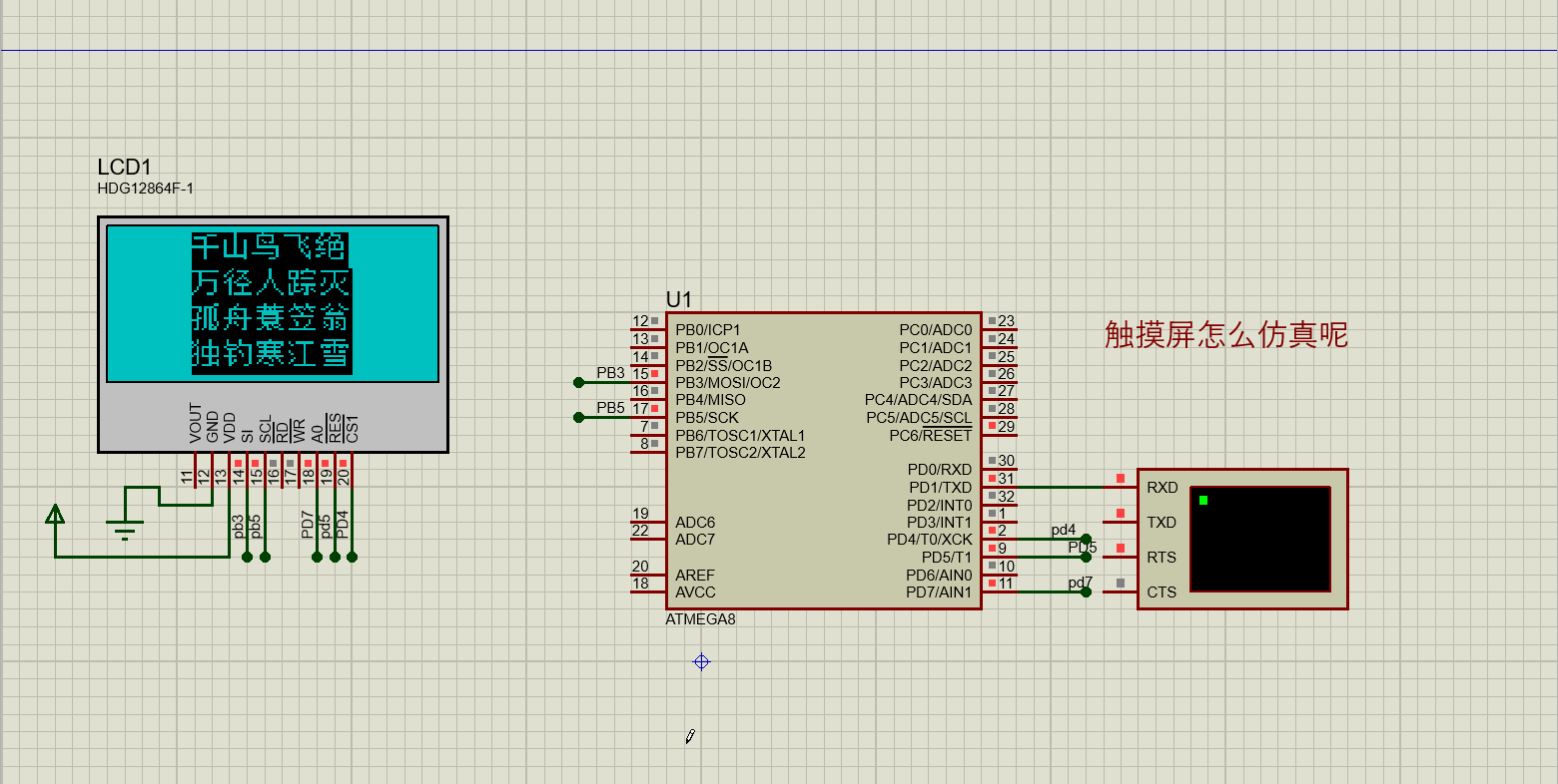

BASCOM版 HDG12864F-1液晶屏演示
ID:342822 發(fā)表于 2020-11-28 22:33 | 顯示全部樓層 |閱讀模式
演示程序:
rem Main.bas file generated by New Project wizard
rem
rem Created:   周五 11月 27 2020
rem Processor: ATmega8
rem Compiler:  BASCOM-AVR
rem Write your code here
'                     EADOGM128.BAS
'               (c) 1995-2020 MCS Electronics
' micro : mega168
' demo  : SPI graphical display EADOGM128
' IMPORTANT : SPI only allows the WRITE mode. THis mean that setting pixels is not possible.
'             for this reason commands as PSET, LINE and CIRCLE are not supported.
'             best option would be to display pictures
' fonts and images are compatible to KS108
$regfile = "m8def.dat"                                    ' ATmega8
$crystal = 8000000
$baud = 19200
$lib "glcdeadogm128x6.lbx"                                  ' specify the used lib
$hwstack = 40
$swstack = 40
$framesize = 40
'the display was connected with these pins
Config Graphlcd = 128x64eadogm , Cs1 = Portd.4 , A0 = Portd.7 , Si = Portb.3 , Sclk = Portb.5 , Rst = Portd.5
'the best option is to control the reset line of the LCD with the micro so you can reset it controlled at startup
Config Adc = Single , Prescaler = Auto , Reference = Avcc
Dim B As Byte , J As Byte
Dim K As Byte , X As Word , Y As Word
Print "cls"
Cls
'specify the font we want to use
Setfont Font8x8tt
'You can use locate but the columns have a range from 1-128
'When you want to show somthing on the LCD, use the LDAT command
'LCDAT Y , COL, value
Lcdat 1 , 1 , "111ABCDE"
Lcdat 2 , 1 , "88888888"
Lcdat 3 , 1 , "MCS Electronics" , 1
Waitms 3000
Dim I As Word
For I = 110 To 113
  Lcdat 1 , 1 , I
  Waitms 500
  Cls 1 , 1 , 24 , 255                                      'clear inverse
  Waitms 500
Next
Waitms 3000
Setfont Font12x16
Cls
Lcdat 4 , 1 , "HDG12864F-1"                                   'a bigger font
Wait 2
CLS
Lcdat 1, 32 ,chr(146); chr(147); chr(148); chr(149); chr(150),1
Wait 2
Lcdat 3, 32, chr(151); chr(152); chr(153); chr(154); chr(155),1
Wait 2
Lcdat 5 , 32, chr(156); chr(157); chr(158);chr(159); chr(160),1
Wait 2
Lcdat 7 , 32, chr(161); chr(162); chr(163); chr(164); chr(165),1
Wait 5
cls
'Setfont Font8x8tt
Showpic 0 , 0 , Plaatje
Waitms 3000
Do
' Gosub Touch                                               'optional touch screen
Loop
End
'portc.0-portc.3 pin 1-4
Touch:                    '幫幫忙這一段不知如何仿真
