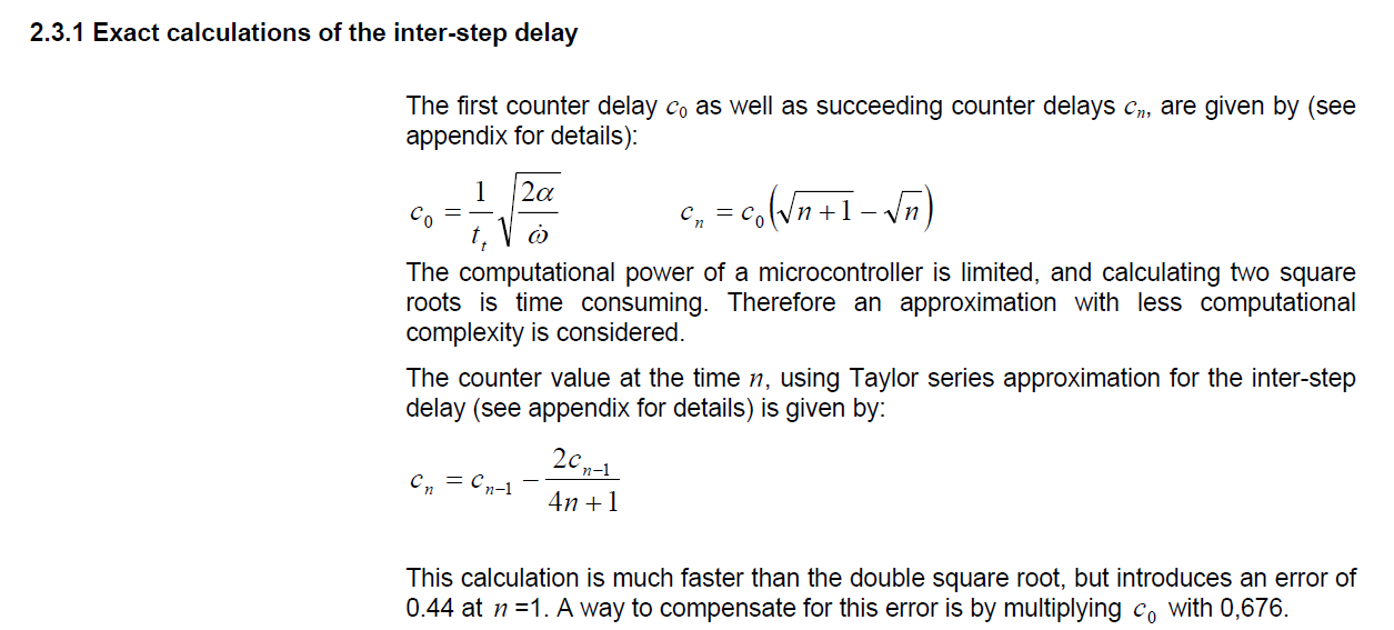

詳細介紹了步進電機直線加速的算法分析To rotate the stepper motor at a constant speed, pulses must be generated at a
steady rate, shown in Figure 2-4.
4baedf38eb3c821e9d39555d0f253016.png 13951ce1be5e660eee51bdc4d83d61a6.png ac5984dcdee7d5a5bb282c5740105855.png
上述的詳細推導過程見附件的附錄
