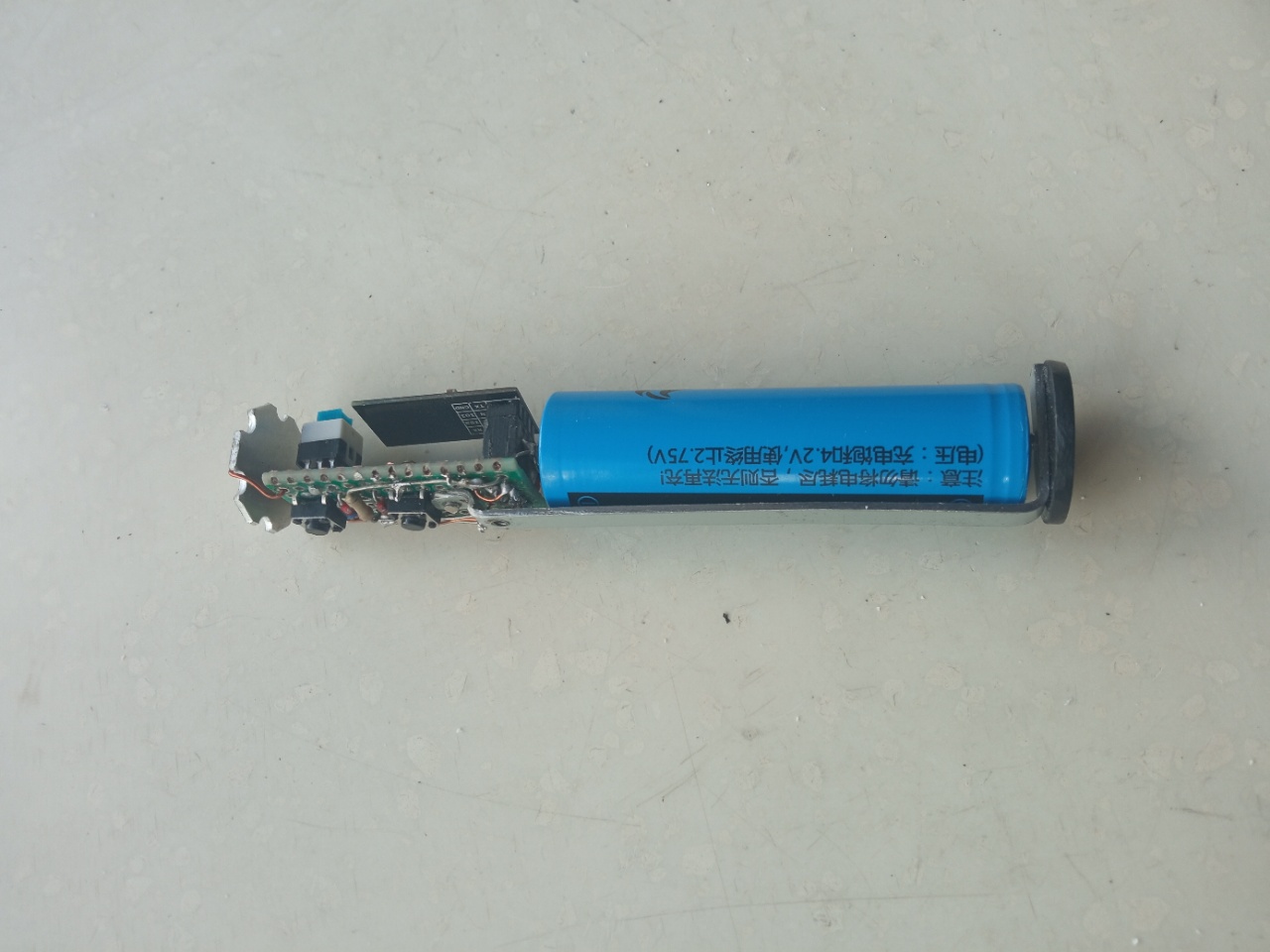

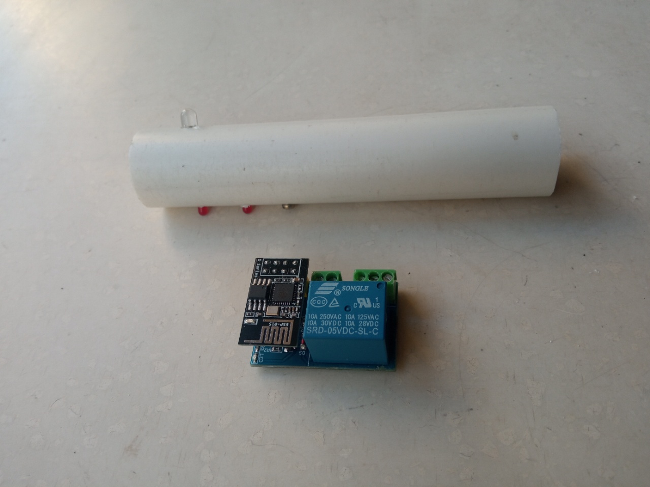

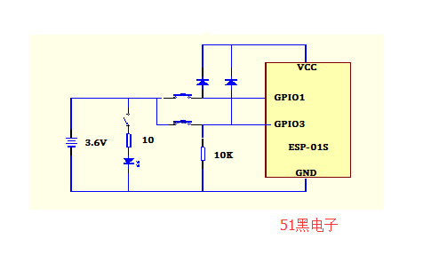

    ESP-01S體積小價格便宜,用兩個ESP-01S就可以制作一個遙控開關。遙控器裝在一個直經2.5厘米長12厘米的塑料線管中。平時還可作為小手電筒使用。開關采用成品模塊,遙控器電路圖與外觀圖如下。如有需求再將收發程序奉上。

//發送程序
#include <ESP8266WiFi.h>
#include <espnow.h>
uint8_t broadcastAddress[] = {0x84, 0xCC, 0xA8, 0xA0, 0x2D, 0xCF};//接收ESP-01S的MAC值,可先用MAC程序獲取。
typedef struct struct_message {
  char a[32];
  int b;
} struct_message;
struct_message myData;
void OnDataSent(uint8_t *mac_addr, uint8_t sendStatus) {
  Serial.print("Last Packet Send Status: ");
  if (sendStatus == 0){
    Serial.println("Delivery success");
  else{
    Serial.println("Delivery fail");
void setup() {
  Serial.begin(115200);
  WiFi.mode(WIFI_STA);
  if (esp_now_init() != 0) {
    Serial.println("Error initializing ESP-NOW");
    return;
pinMode(1,INPUT);
pinMode(3,INPUT);
  esp_now_set_self_role(ESP_NOW_ROLE_CONTROLLER);
  esp_now_register_send_cb(OnDataSent);
  esp_now_add_peer(broadcastAddress, ESP_NOW_ROLE_SLAVE, 1, NULL, 0);
void loop() {
if(digitalRead(1)==HIGH) myData.b = 1;
if(digitalRead(3)==HIGH) myData.b = 2;
  esp_now_send(broadcastAddress, (uint8_t *) &myData, sizeof(myData));
  delay(2000);
//MAC
void setup(){
Serial.println();
Serial.print("ESP8266 Board MAC Address: ");
Serial.println(WiFi.macAddress());
void loop()
//接收程序
#include <espnow.h>
int k;
char a[32];
int b;
} struct_message;
void OnDataRecv(uint8_t * mac, uint8_t *incomingData, uint8_t len) {
memcpy(&myData, incomingData, sizeof(myData));
Serial.print("Int: ");
Serial.println(myData.b);
k=myData.b;
Serial.println();
void setup() {
return;
pinMode(0,OUTPUT);
digitalWrite(0, LOW);
pinMode(2,OUTPUT);
digitalWrite(2, LOW);
esp_now_set_self_role(ESP_NOW_ROLE_SLAVE);
esp_now_register_recv_cb(OnDataRecv);
void loop(){
if(k==2) {
if(k==1) {
digitalWrite(0, HIGH);
digitalWrite(2, HIGH);
