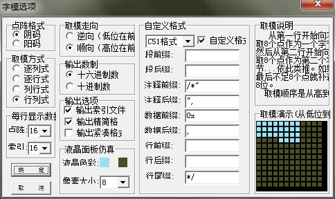

  2.2        頂端菜單欄,點擊[選項]按下方圖片設置,設置完畢后點擊[確定]保存設置。

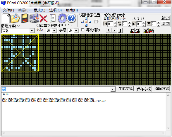

  2.3        回到主界面,在輸入框中輸入“我”點擊[生成字模]。
  取得的字模數據如下:
0x04,0x0E,0x78,0x08,0x08,0xFF,0x08,0x08,0x0A,0x0C,0x18,0x68,0x08,0x08,0x2B,0x10
0x40,0x50,0x48,0x48,0x40,0xFE,0x40,0x44,0x44,0x48,0x30,0x22,0x52,0x8A,0x06,0x02/*"我",0*/

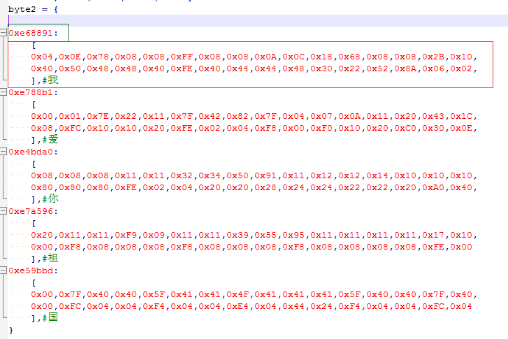

  2.4        將取到的字模數據添加到font.py中。
  綠色框中是“我”的16進制utf-8編碼。
  在線工具:http://tool.lu/hexstr/
  參照以上方法,我依次添加了“我愛你祖國”這5個漢字的字模。
byte2  = {
0xe68891:
     0x04,0x0E,0x78,0x08,0x08,0xFF,0x08,0x08,0x0A,0x0C,0x18,0x68,0x08,0x08,0x2B,0x10,
     0x40,0x50,0x48,0x48,0x40,0xFE,0x40,0x44,0x44,0x48,0x30,0x22,0x52,0x8A,0x06,0x02,
0xe788b1:
     0x00,0x01,0x7E,0x22,0x11,0x7F,0x42,0x82,0x7F,0x04,0x07,0x0A,0x11,0x20,0x43,0x1C,
     0x08,0xFC,0x10,0x10,0x20,0xFE,0x02,0x04,0xF8,0x00,0xF0,0x10,0x20,0xC0,0x30,0x0E,
0xe4bda0:
    0x08,0x08,0x08,0x11,0x11,0x32,0x34,0x50,0x91,0x11,0x12,0x12,0x14,0x10,0x10,0x10,
     0x80,0x80,0x80,0xFE,0x02,0x04,0x20,0x20,0x28,0x24,0x24,0x22,0x22,0x20,0xA0,0x40,
0xe7a596:
     0x20,0x11,0x11,0xF9,0x09,0x11,0x11,0x39,0x55,0x95,0x11,0x11,0x11,0x11,0x17,0x10,
     0x00,0xF8,0x08,0x08,0x08,0xF8,0x08,0x08,0x08,0xF8,0x08,0x08,0x08,0x08,0xFE,0x00
0xe59bbd:
     0x00,0x7F,0x40,0x40,0x5F,0x41,0x41,0x4F,0x41,0x41,0x41,0x5F,0x40,0x40,0x7F,0x40,
     0x00,0xFC,0x04,0x04,0xF4,0x04,0x04,0xE4,0x04,0x44,0x24,0xF4,0x04,0x04,0xFC,0x04

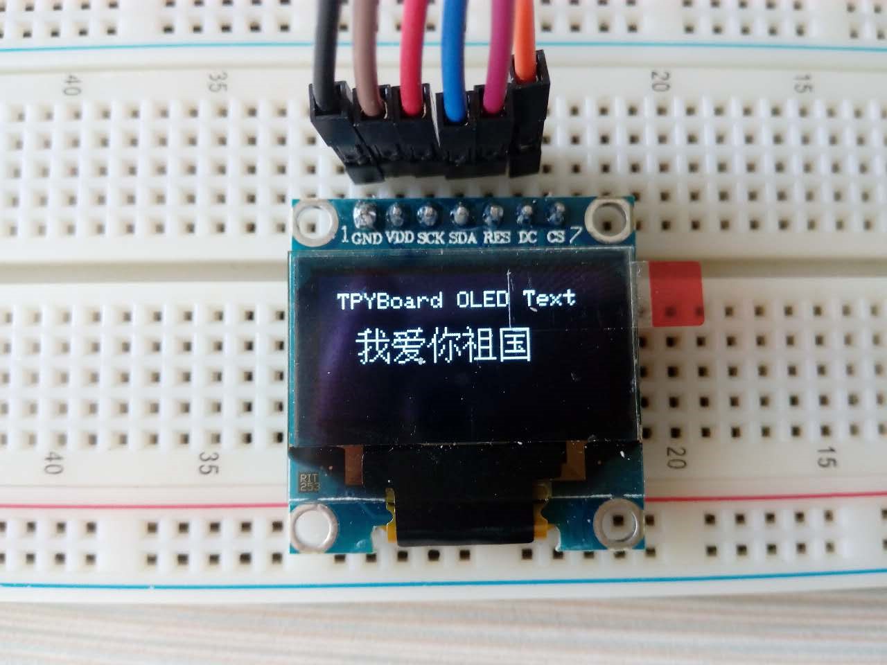

  0x04效果展示
  硬件接線OK后,將源碼全部拷貝到TPYBaordv102加載的磁盤中,按下RST按鍵復位或者使用Putty軟件Ctrl+D軟復位,重新運行效果如下:
