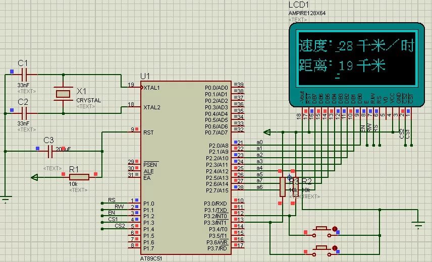

ID:77367 發表于 2015-4-19 03:13 | 顯示全部樓層 |閱讀模式
下位機傳遞程序
下位機發送信息
#include<reg51.h>
#define uchar unsigned char
#define uint  unsigned int
sbit DDD=P3^6;
uint TT;
void delay(uchar time)
uchar i;
while(time--)
for(i=0;i<60;i++);
void send(uchar state)
  SBUF=state;
  while(TI==0);
   TI=0;
void SCON_init()
SCON=0X40;//選擇串口通信方式1
TMOD=0x20;//設置計數器T1為計數方式2(自動重裝初值)
PCON=0x00;//設置波特率倍增
TH1=0xFD;
TL1=0xFD;
TI=0;
TR1=1;
void main()
SCON_init();
while(1)
TT=P1;
if(TT!=0xff)
    delay(1);
    if(TT!=0xff)
    DDD=0;
       send(P1);
    DDD=1;
  else DDD=1;
  else DDD=1;
/*           上位機接收和處理程序             */
#include"reg51.h"
sbit RS=P1^0;
sbit RW=P1^1;
sbit EN=P1^2;
sbit DDD=P1^6;
sbit DD=P3^6;
sbit CS1=P1^3;
sbit CS2=P1^4;
uchar code num[][16]={
{0x00,0xE0,0x10,0x08,0x08,0x10,0xE0,0x00,0x00,0x0F,0x10,0x20,0x20,0x10,0x0F,0x00},
//"0",0
{0x00,0x10,0x10,0xF8,0x00,0x00,0x00,0x00,0x00,0x20,0x20,0x3F,0x20,0x20,0x00,0x00},
//"1",1
{0x00,0x70,0x08,0x08,0x08,0x88,0x70,0x00,0x00,0x30,0x28,0x24,0x22,0x21,0x30,0x00},
//"2",2
{0x00,0x30,0x08,0x88,0x88,0x48,0x30,0x00,0x00,0x18,0x20,0x20,0x20,0x11,0x0E,0x00},
//"3",3
{0x00,0x00,0xC0,0x20,0x10,0xF8,0x00,0x00,0x00,0x07,0x04,0x24,0x24,0x3F,0x24,0x00},
//"4",4

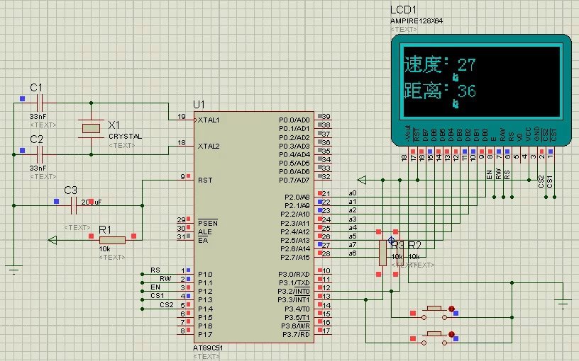

void main(void)
  IT0=1;//中斷觸發方式,IT0=1下降沿產生中斷信號,IT0=0,低電平產生中斷信號
  TMOD=0x01;
  TL0=0xb0;
  TH0=0x3c;
  EX0=1;//EX0=1允許外中斷,即分中斷開關,1打開,0禁止外中斷
  ET0=1;
  PX0=1;//外中斷0優先
  PT0=0;
  EA=1; //打開總中斷開關

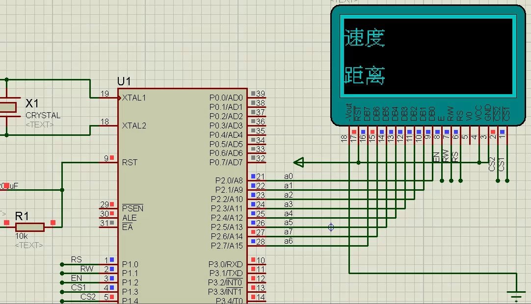

  //LCD_init();
   CS1=1;
   CS2=0;
  for(xs=0;xs<6;xs++)
       for(ys=0;ys<63;ys++)
           switch(xs)
                 case 0:if(ys<16)
                           disp(xs,ys,~qian[ys]);
                        if((ys>15)&&(ys<32))
                           disp(xs,ys,~mi[ys-16]);
                        if((ys>31)&&(ys<=48))
                           disp(xs,ys,~gong[ys-32]);
      if(ys>47)
         disp(xs,ys,~shi[ys-48]);
                        break;
                 case 1:if(ys<16)
                           disp(xs,ys,~qian[ys+16]);
                           disp(xs,ys,~mi[ys]);
                           disp(xs,ys,~gong[ys-16]);
      if(ys>47)
         disp(xs,ys,~shi[ys-32]);
                        break;
     case 2:if(ys<16)
                        break;
                 case 3:if(ys<16)
                        break;
   CS1=0;
   CS2=1;
  for(xs=0;xs<6;xs++)
           switch(xs)
                 case 0:if(ys<16)
                           disp(xs,ys,~spd0[ys]);
                           disp(xs,ys,~spd1[ys-16]);
                           disp(xs,ys,~mh[ys-32]);
                        break;
                 case 1:if(ys<16)
                           disp(xs,ys,~spd0[ys+16]);
                           disp(xs,ys,~spd1[ys]);
                           disp(xs,ys,~mh[ys-16]);
                        break;
     case 2:if(ys<16)
                           disp(xs,ys,~lgth0[ys]);
                           disp(xs,ys,~lgth1[ys-16]);
                        if((ys>31)&&(ys<=44))
                        break;
                 case 3:if(ys<16)
                           disp(xs,ys,~lgth0[ys+16]);
                           disp(xs,ys,~lgth1[ys]);
                           disp(xs+1,ys,~mh[ys-16]);
                        break;
   TR0=1;
  while(1)
  if(DDD==0)
    mov();
  for(xs=0;xs<6;xs++)
       for(ys=0;ys<60;ys++)
           switch(xs)
                 case 0:
                        if((ys>44)&&(ys<=52))
                           disp(xs,ys,~num[spd00][ys-44]);
                        if(ys>52)
         disp(xs,ys,~num[spd01][ys-52]);
                        break;
                 case 1:
                           disp(xs,ys,~num[spd00][ys-36]);
                        if(ys>52)
         disp(xs,ys,~num[spd01][ys-44]);
                        break;
     case 2:
                           disp(xs,ys,~num[d0][ys-44]);
                        if(ys>52)
         disp(xs,ys,~num[d1][ys-52]);
                        break;
                 case 3:
                           disp(xs,ys,~num[d0][ys-36]);
                         if(ys>52)
         disp(xs,ys,~num[d1][ys-44]);
                        break;
void distant() interrupt 0
d++;                   //跑步機圈數計數?
dist=d+d/2;            //假定一圈1.5米,根據跑步機一圈定
//一下看顯示距離,也可在主程序中根據情況確定如果顯示
wd0=(dist)/100;        //顯示以百米為單位,可根據情況顯示
wd1=((dist)%100)/10;
dw2=((dist)%100)%10;
void time0() interrupt 1
   time++;
   if (time==20)   //50ms計數20次為1秒
   time=0;
   sec++;   //秒
   if(sec==60)
      min++;//分鐘
   TL0=0xb0;//重裝計數初值
   TH0=0x3c;
   d0=min/10;//秒顯示
   d1=min%10;
   v=(dist*36)/(10*sec);//速度計算。速度,千米/小時
   spd00=v/10;//速度顯示
   spd01=v%10;

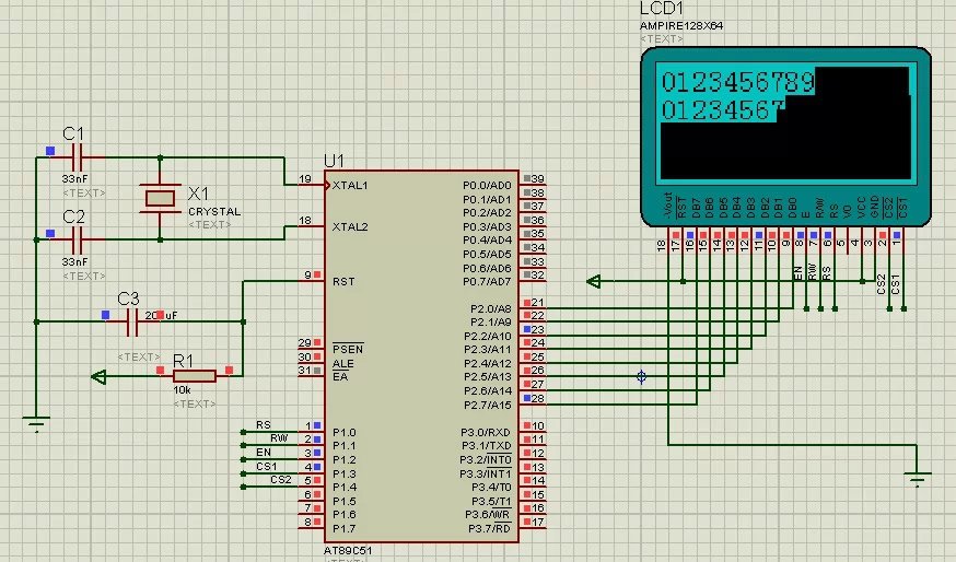

#include"reg51.h"
sbit RS=P1^0;
sbit RW=P1^1;
sbit EN=P1^2;
sbit CS1=P1^3;
sbit CS2=P1^4;
//"0",0
//"1",1
//"2",2
//"3",3
//"4",4
{0x00,0xF8,0x08,0x88,0x88,0x08,0x08,0x00,0x00,0x19,0x21,0x20,0x20,0x11,0x0E,0x00},
//"5",5
{0x00,0xE0,0x10,0x88,0x88,0x18,0x00,0x00,0x00,0x0F,0x11,0x20,0x20,0x11,0x0E,0x00},
//"6",6
{0x00,0x38,0x08,0x08,0xC8,0x38,0x08,0x00,0x00,0x00,0x00,0x3F,0x00,0x00,0x00,0x00},
//"7",7
{0x00,0x70,0x88,0x08,0x08,0x88,0x70,0x00,0x00,0x1C,0x22,0x21,0x21,0x22,0x1C,0x00},
//"8",8
{0x00,0xE0,0x10,0x08,0x08,0x10,0xE0,0x00,0x00,0x00,0x31,0x22,0x22,0x11,0x0F,0x00} //"9",9
int k,m,n,i;
void delay(int ms)
while(ms--)
for(i=0;i<120;i++);
void write_comd(char dat)
  RW=0;
  RS=0;
  P2=dat;
  EN=1;
  delay(1);
  EN=0;
void write_data(char dat)
  RW=0;
  RS=1;
  P2=dat;
  EN=1;
  delay(1);
  EN=0;
void disp(char x,char y,char dat)
   if(y>=64)
      y=y-1;
write_comd(0x40|y);
delay(5);
write_comd(0xb8|x);
write_data(dat);
void LCD_init(void)
   write_comd(0x38);//設置8位格式,2行,5x7
   write_comd(0x0c);//整體顯示,關光標,不閃爍
   write_comd(0x06);//設定輸入方式,增量不移位
   write_comd(0x01);//清除屏幕顯示---
void main(void)
  LCD_init();
  while(1)
       for(k=0;k<8;k++)
               for(n=0;n<10;n++)
                        if (n<8)
                             CS1=0;
                             CS2=1;
                       else
                           CS1=1;
                           CS2=0;
                      for(m=0;m<16;m++)
                              if(m<8)
                                disp(2*k,m+8*n,num[n][m]);
                              else
                                disp(2*k+1,m+8*n-8,num[n][m]);
                             delay(10);
