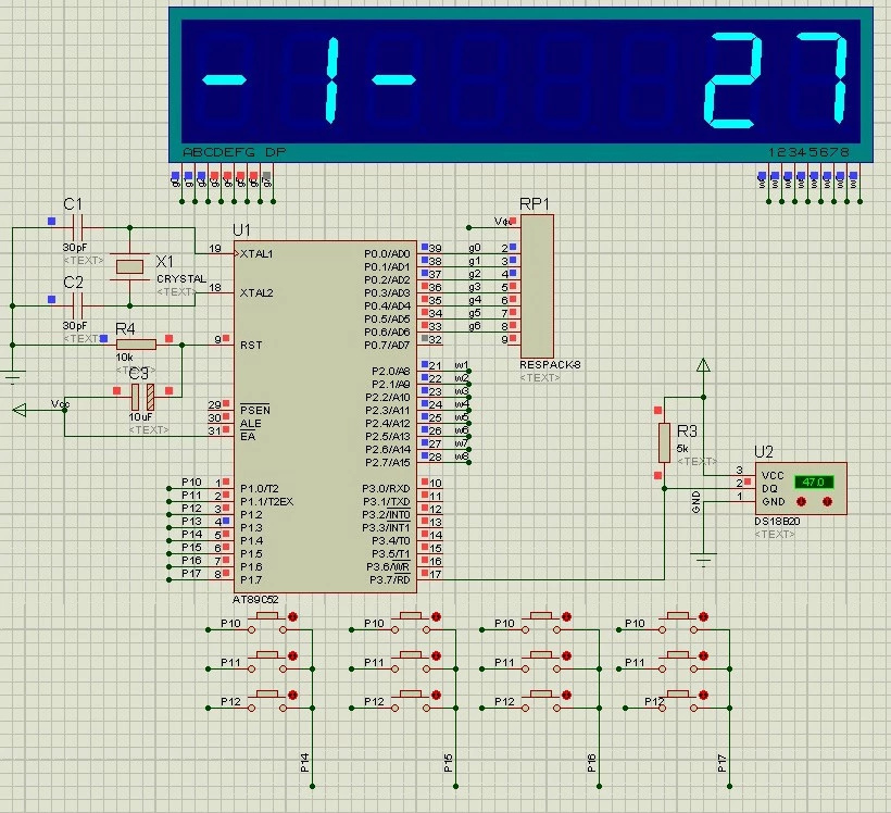

3.復合按鍵程序
#include<AT89X51.h>
#define uchar unsigned char
#define uint unsigned int
uint key_H;//高電平計次
uchar k,n,range,temp,TH=20,TL=30;
bit key_flag; //高電平狀態標志位
unsigned char  code tabca[]={0xc0,0xf9,0xa4,0xb0,0x99,0x92,
                             0x82,0xf8,0x80,0x90,0x00,0xbf};//共陽極

void main(void)
   temp=27;
   while(1)
        LED_7seg_dis(8,11);
  LED_7seg_dis(7,range);
        LED_7seg_dis(6,11);
        k=keybd_4x4();
        n=key_do();                  //按鍵值
        LED_7seg_dis(2,temp/10);
  LED_7seg_dis(1,temp%10);
