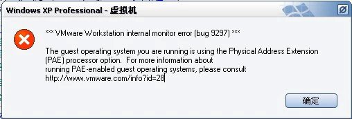

       大概半個月前,我就從網上down了個漢化版的VMware Workstation 5.0,,打算裝個Windows Server 2003,從同學處借來光盤后,安裝過程中出了一些問題,我也沒多想就沒裝了,直接裝到了電腦上的E盤,我的電腦就成了雙系統了,,記得那時這個win 2003不能驅動我的網卡,我為了驅動它可費了我的一番心血啊,那是笨啦!我的主板是華碩的,P5GC-MX/1333,不知道去生產商的網站去下,總算找了半天在個不知名的小網站找到了~~現在總結了一點,那就是Windows Server 2003面向服務器的,它里面只集成了一些高性能的網卡的驅動程序,我的垃圾網卡就驅動不了,還有聲卡沒驅動,也挺費勁了找到了一個萬能聲卡驅動,AUD_ALLOS_XP_VISTA_5377_PV_REALTEK.EXE,閑話就不多說了,今天我又下了個深度Windows XP SP3 完美精簡 v6.2 正式版來裝,結果中途有來問題了,彈出個框框,我把它截圖了
還好我能看懂點英文,我按照它提示的一個網址www.vmware.com/info?id=28找到了答案,
Details
While I was trying to install a guest operating system, or upgrade an existing legacy virtual machine, my VMware product displayed a message that said the guest operating system was trying to use PAE. How can I correct the problem?
Solution
Below are two situations in which this error message appears:
  • The host computer has a processor that includes NX (no execute) or XD (execute disable) technology, the host operating does not support the NX or XD bit, and the guest operating system makes use of the NX or XD bit. Affected guest operating systems include Windows XP SP2, Windows Server 2003, Red Hat Enterprise Linux 4, Red Hat Enterprise Linux 3 Update 3, and Solaris 10.
    The NX technology is present in AMD processors including Athlon64, Opteron, and Sempron. The XD technology is present in Intel EMT64-capable processors.
  • You start a virtual machine created by VMware ESX Server, VMware GSX Server 2.0.1 or earlier, or VMware Workstation 3.x or earlier.
To resolve the issue:
  • If you have a NX technology-enabled system, change or upgrade the host operating system to one that supports the NX or XD bit.
  • If your host operating system is not PAE-enabled, but the guest is, power off the virtual machine and use a text editor to edit  the VMX file (.vmx) for the affected virtual machine.
    Search for a line beginning with:
    paevm =
    If the line appears, change it to:
    paevm = "TRUE"
    If the line does not exist, add it with the value of true as shown in the above example.
You can then power on the virtual machine and run a PAE enabled guest operating system in it.
For more information about editing the virtual machine's configuration file, see http://kb.vmware.com/kb/1714.
Note: If you run the Microsoft Application Compatibility Toolkit on a Windows XP Service Pack 1 system that has VMware Workstation 5 installed, the Application Compatibility Toolkit identifies Workstation as a program that has problems on Windows XP Service Pack 2. It identifies Workstation because of the issue described in this article. The workarounds described in this article resolve the issue.

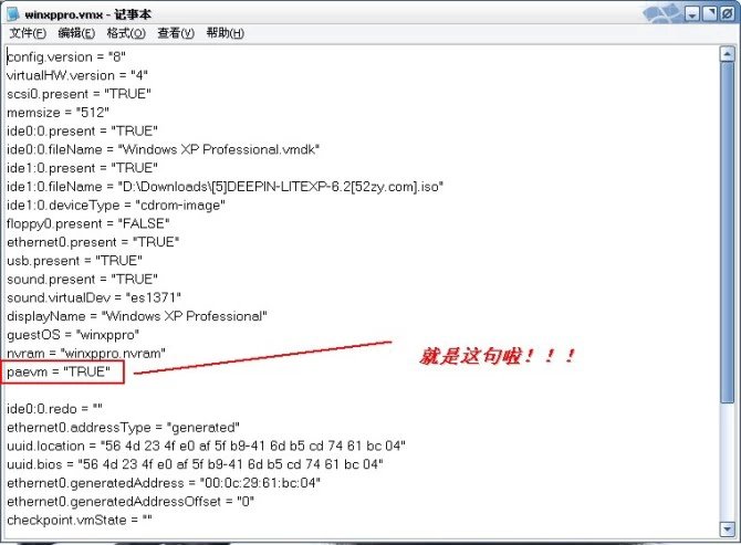

呵呵~我的問題很簡單,用搜索搜到我的winxppro.vmx,用記事本打開,在里面添上一句paevm = "TRUE",重啟OKay!!!!!!!!!!
